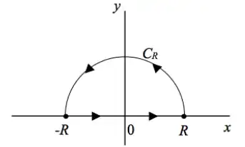

Write$$I = \int_{0}^{\infty} \underbrace{\frac{x - \sin(x)}{x^3\left(x^2 + 4\right)}}_{:=g(x)} ~\mathrm dx=\frac 12 \int_{-\infty}^{\infty} g(x) ~\mathrm dx.$$ Let $f(z)=\dfrac{z+ie^{iz}}{z^3(z^2+4)}$, so $\Re f(x)=g(x).$
Take the contour
Then we have two poles ($z=0$ on the contour and $z=2i$ inside the contour), $$\int_{C_R}f(z)~\mathrm dz+\int_{-R}^R f(z)~\mathrm dz=\pi i \operatorname{Res}_{z=0}f(z)+2\pi i \operatorname{Res}_{z=2i}f(z).\tag{*}$$ By ML lemma, $$\lim_{R\to\infty}\int_{C_R}f(z)~\mathrm dz=0.$$ We also calculate the residue of the function at $z=0$ by means of power series: \begin{align*} f(z)=\frac14\frac{z+ie^{iz}}{z^3}\frac{1}{1-(-\frac{z^2}{4})}&=\frac14\frac1{z^3}\left[z+i\left(1+iz-\frac{z^2}{2}-\frac{iz^3}{6}+\cdots\right)\right]\left(1-\frac{z^2}4+\cdots\right)\\ &=\cdots+\frac14\left(-\frac i2-\frac i4\right)\frac 1z+\cdots \end{align*} implies $$\operatorname{Res}_{z=0}f(z)=\frac14\left(-\frac i2-\frac i4\right)=-\frac{3i}{16},$$ and the residue at $z=2i$ is $$\operatorname{Res}_{z=2i}f(z)=\lim_{z\to 2i}(z-2i)f(z)=\frac{(2+e^{-2})i}{32}.$$ Thus, from $(*)$, $$\int_{-\infty}^\infty f(x) ~\mathrm dx =\frac{3\pi}{16}-\frac{(2+e^{-2})\pi}{16}=\frac{1}{16}(1-e^{-2}).$$
$$\therefore I=\frac 12 \Re\int_{-\infty}^{\infty} g(x) ~\mathrm dx=\frac{1}{32}(1-e^{-2}).$$
