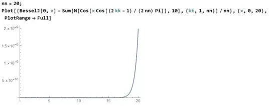

Though I suppose we could use Chebyshev-Gauss quadrature here to avoid the singularity. From a quick numerical experiment we should pick $n \approx x$, then we get very accurate expression:
$$J_0(x) \approx \frac{1}{n} \sum_{k=1}^n \cos \left(x \cos \left( \frac{2k-1}{2n} \pi \right) \right)$$
This may be even better than any approximation above, as it works in a greater domain provided we pick $n$ large enough.
Here's an example for $n=20$, which shows that the approximation is very good.
