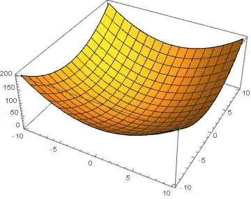

$(2)$ On the contrary, when you plot a function that maps from $\mathbb{R^2} \rightarrow \mathbb{R}$ like $f(x,y)=x^2 +y^2$, when you want to plot this you often define a third variable $z=f(x,y)$ and you let the value of this variable be equal to the function value. I have plotted $x^2 +y^2$ in this way below: enter image description here

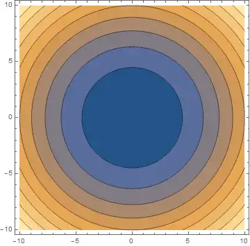

Without introducing another axis, we can also just give different function value ranges a different colour, so a large value could be very dark and a low value could be very light or vice versa. We recognise the same function:

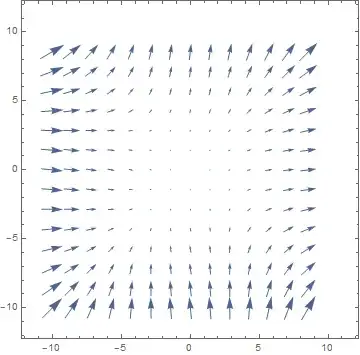

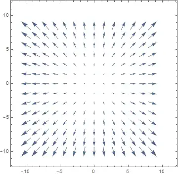

The difference between $(1)$ and $(2)$ is the notion of direction. The function you describe is usually a "scalar field", we only have the notion of magnitude or "value" but not of direction. Gradients will give you a so-called "vector field" as physicists often call it, we usually visualise this using VectorPlots. Below you find such a method, I've plotted the vector field $f(x,y)=(x^2+y,y^2+x )$
which has gradient $grad(f)(x,y)=(2x,2y)$
