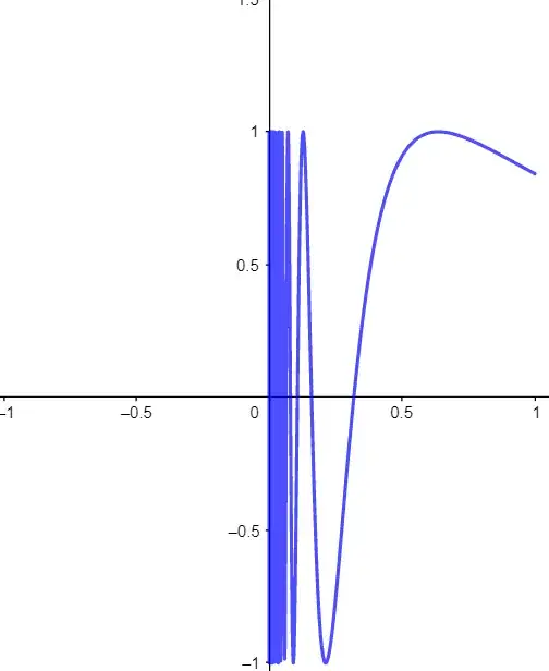

Consider the graph of the $\sin(\frac{1}{x})$ function on $(0,1]$.

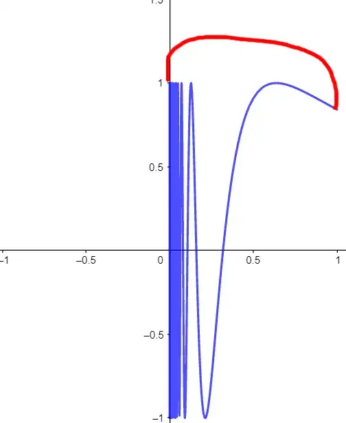

Let $X$ be the space which consists of this graph together with the vertical line segment connecting $(0,-1)$ and $(0,1)$, and the curve in red:
$X$ is a metric space that is path connected. You can also clearly see this as an open subset of $X$:

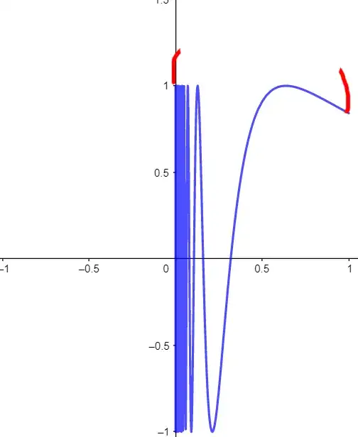

This is an open connected subspace of the $X$ that is not path connected.
This counter example is a metric space. It applies as well for the general case of topological spaces.
