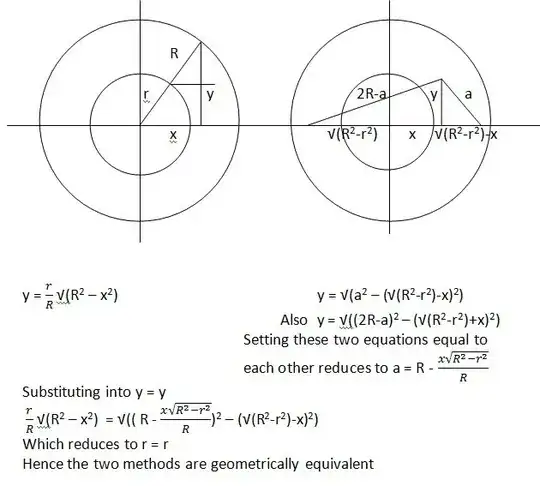

This answer is a little unsatisfying, as it amounts to: The two geometric constructions are equivalent, because the relations describing them are algebraically equivalent. I believe it's possible to remove some of the algebra, but I haven't found the cleanest way to do it ... yet!

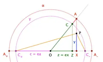

Defining $z := ex$, we can write $(4)$ as
$$(a+z)^2 = y^2 + ( c+x )^2 \tag{5}$$
We interpret $(5)$ geometrically by introducing a third circle, $\gamma$, centered at $O$ and having radius $c$. Let $\gamma$ meet the variable ray at $C$ and the "horizontal" diameter-line at $C_{+}$ and $C_{-}$. Also, let $Z$ be the projection of $C$ onto that diameter. (While we're at it, let's say that the diamter meets $\alpha$ at $A_{+}$ and $A_{-}$.)
Now, $a=|OA_{+}|$ and $c=|OC_{+}|$, while proportionality tells us that $z = |OZ|$. We also have
$$y = |PX|,\qquad a+z = |A_{+}Z|,\qquad c+x = |C_{+}X| \tag{6}$$
so that $(5)$ implies, by way of right triangle $\triangle PXC_{+}$,
$$|A_{+}Z|^2 = |PX|^2 + |C_{+}X|^2 = |PC_{+}|^2 \quad\to\quad |A_{+}Z|=|PC_{+}| \quad\left(\text{likewise,}\; |A_{-}Z| = |PC_{-}|\right) \tag{7}$$
The reader may notice that @PhilH's expression for what he calls "$a$" amounts to the same observation. Even so, it's interesting (to me) to formulate things thusly:
Circle $\gamma$ meets the variable ray at a point whose projection onto the "horizontal" diameter of $\alpha$ divides that diameter into precisely the segments needed to join the foci to $P$.
I have no doubt that this interpretation exists in the literature; however, I only recently realized it, myself. Be that as it may ... We have recaptured the fact that the sum of the focus-to-$P$ distances is constant, namely the diameter of $\alpha$. $\square$
