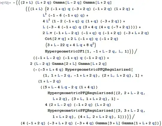

I have an answer but I use Mathematica 10 for it. Set $$ A_0(L,q,x):=\sum^{\infty}_{l=0}\sum^{\infty}_{r=0}\frac{\Gamma(L+r-2q)\Gamma(L+r+l-1+2q)}{\Gamma(L+r-1+2q)\Gamma(L+r+l+2)}(r+1)x^{l+r+1}. $$ Then using Mathematica evaluate $A_0(L,q,x)$ and FullSimplify it. You will get result. Then integrate the result $$ \int^{1}_{0}A_0(L,q,t)dt $$ and FullSimplify it. You get a function of $\cot$, $\Gamma$, ${}_2F_1$ and ${}_3F_2$ functions. But you have to wait a while.
The function ${}_2F_1$ is computable with elementary functions. It is actualy $$ {}_2F_1(1,-1+L-2q;L;1)=\frac{L-1}{2q} $$ For the ${}_3F_2$, you have to evaluate $$ {}_3F_2(1,1+L-2q,-1+L+2q;2+L,L+2q;1),\tag 1 $$ $$ {}_3F_2(2,2+L-2q,L+2q;3+L,1+L+2q;1)\tag 2 $$ and $$ {}_3F_2(3,3+L-2q,1+L+2q;4+L,2+L+2q;1).\tag 3 $$ Note that these are the zero, first and second derivatives of $$ {}_3F_2(1,1+L-2q,-1+L+2q;2+L,L+2q;x)\tag 4 $$ at $x=1$. So actualy, you have to compute $(4)$, or if you prefere the values $(1),(2),(3)$. The function $(4)$ also referes to the problem of finding $$ \sum^{\infty}_{n=0}\frac{\Gamma(n+a)\Gamma(n+b)}{\Gamma(n+c)\Gamma(n+d)}x^n $$ So the final answer is enter image description here
$\ldots$
CONTINUED
Assume that $$ F_1(L,q,x):=\sum^{\infty}_{l=0}\sum^{\infty}_{r=0}\frac{\Gamma(L+r-2q)\Gamma(L+r+l-1+2q)}{\Gamma(L+r-1+2q)\Gamma(L+r+l+2)}x^lx^r. $$ Then $$ F_1(L,q,x)=-\frac{\Gamma(L-2q)(L-2q-1)}{4q-2}{}_2\widetilde{F}_1\left(1,L-2q;L+2;x\right)+ $$ $$ \frac{(L+2q-2)\Gamma(L-2q)}{4q-2}{}_2\widetilde{F}_1\left(1,L+2q-1;L+2;x\right)- $$ $$ -\frac{\Gamma(L-2q)}{4q-2}{}_2\widetilde{F}_1\left(2,L-2q;L+2;x\right), $$ where $$ {}_p\widetilde{F}_q\left(a_1,a_2,\ldots,a_p;b_1,b_2,\ldots,b_q;z\right):= $$ $$ {}_pF_q\left(a_1,a_2,\ldots,a_p;b_1,b_2,\ldots,b_q;z\right)/(\Gamma(b_1)\Gamma(b_2)\ldots\Gamma(b_q)) $$ is the regularized hypergeometric function.
Set now $$ F_2(L,q,x):=\sum^{\infty}_{l=0}\sum^{\infty}_{r=0}\frac{\Gamma(L+r-2q) \Gamma(L+r+l-1+2q)}{\Gamma(L+r-1+2q) \Gamma(L+r+l+2)}rx^lx^r. $$ Then $$ F_2(L,q,x)= $$ $$ =\frac{x\Gamma(L-2q+1)(2+L-6q-4Lq+8q^2)}{2(2q-1)(4q-3)\Gamma(L+3)}{}_2F_1\left(2,L-2q+1;L+3;x\right)- $$ $$ -\frac{\Gamma(L-2q+1)(L+2q-2)}{2(2q-1)(4q-3)\Gamma(L+2)}{}_2F_1(1,L-2q;L+2;x)+ $$ $$ +\frac{\Gamma(L-2q+1)(L+2q-2)}{2(2q-1)(4q-3)\Gamma(L+2)}{}_2F_1(1,L+2q-1;L+2;x)- $$ $$ -x\frac{\Gamma(L-2q+1)}{(4q-3)\Gamma(L+3)} {}_3F_2\left(2,2,L-2q+1;1,L+3;x\right). $$ But $$ F_3(L,q,x) =\sum^{\infty}_{l=0}\sum^{\infty}_{r=0}\frac{\Gamma(L+r-2q) \Gamma(L+r+l-1+2q)}{\Gamma(L+r-1+2q) \Gamma(L+r+l+2)}(r+1)x^lx^r= $$ $$ =F_1(L,q,x)+F_2(L,q,x) $$ and $$ S=S(L,q)=\int^{1}_{0}x\cdot F_3(L,q,x)dx $$ But also $$ k_{11}(b,c):=\int^{1}_{0}x\cdot { }_2F_1(1,b;c;x)dx= $$ $$ =\frac{(c-1)}{(b-1)(b-2)}\left[2-b+(c-2)\psi(c-2)-(c-2)\psi(c-b)\right], $$ where $Re(b)<Re(c)$. $$ k_{12}(b,c):=\int^{1}_{0}x\cdot {}_2F_1(2,b;c;x)dx= $$ $$ =\frac{(c-1)(c-2)}{(b-1)(b-2)}\left[-1+{}_2F_1(1,b-2;c-2;1)-\psi(c-2)+\psi(c-b)\right] $$ $$ k_{21}(b,c):=\int^{1}_{0}x^2\cdot { }_2F_1(1,b;c;x)dx =\frac{(c-1)}{2(b-1)(b-2)(b-3)}\times $$ $$ \times\left[-(b-3)(2c+b-6)+2(c-3)(c-2)\psi(c-3)-2(c-3)(c-2)\psi(c-b)\right], $$ $$ k_{22}(b,c):=\int^{1}_{0}x^2\cdot { }_2F_1(2,b;c;x)dx =\frac{(c-1)(c-2)}{(b-1)(b-2)(b-3)}\times $$ $$ \times\left[b-c+(c-3){}_2F_1(1,b-3;c-3;1)-2(c-3)\psi(c-3)+2(c-3)\psi(c-b)\right], $$ and $$ M(b,c):=\int^{1}_{0}x^2\cdot { }_3F_2(2,2,b;1,c;x)dx= $$ $$ =-\frac{18}{(b-3)(b-2)(b-1)}-\frac{2b}{(b-3)(b-2)(b-1)}+ $$ $$ \frac{(c-4)(c-3)(c-2)(c-1)}{(b-1)(b-2)(b-c+1)(b-c+2)} +\frac{35c}{(b-1)(b-2)(b-3)}+ $$ $$ +\frac{3bc}{(b-1)(b-2)(b-3)}-\frac{21c^2}{(b-1)(b-2)(b-3)} -\frac{bc^2}{(b-1)(b-2)(b-3)}+ $$ $$ +\frac{4c^3}{(b-1)(b-2)(b-3)}-\frac{4(c-1)(c-2)(c-3)(c-4)}{(b-1)(b-2)(b-3)(c-b-1)}+ $$ $$ +\frac{4(-6+11c-6c^2+c^3)\psi(c-3)}{(b-1)(b-2)(b-3)}-\frac{4(-6+11c-6c^2+c^3)\psi(b-c)}{(b-1)(b-2)(b-3)}, $$ where $2+Re(b)<Re(c)$.
Hence the value of the double sum (tag $(0)$) is $$ S=S(L,q)=-\frac{\Gamma(L-2q)(L-2q-1)}{(4q-2)\Gamma(L+2)} k_{11}(L-2q,L+2)+ $$ $$ +\frac{(L+2q-2)\Gamma(L-2q)}{(4q-2)\Gamma(L+2)}k_{11}(L+2q-1,L+2)- $$ $$ -\frac{\Gamma(L-2q)}{(4q-2)\Gamma(L+2)}k_{12}(L-2q,L+2)+ $$ $$ +\frac{\Gamma(L-2q+1)(2+L-6q-4Lq+8q^2)}{2(2q-1)(4q-3)\Gamma(L+3)}k_{22}(L-2q+1,L+3)- $$ $$ -\frac{\Gamma(L-2q+1)(L+2q-2)}{2(2q-1)(4q-3)\Gamma(L+2)}k_{11}(L-2q,L+2)+ $$ $$ +\frac{\Gamma(L-2q+1)(L+2q-2)}{2(2q-1)(4q-3)\Gamma(L+2)}k_{11}(L+2q-1,L+2)- $$ $$ -\frac{\Gamma(L-2q+1)}{(4q-3)\Gamma(L+3)}M(L-2q+1,L+3). $$ Where $$ \psi(x):=\frac{\Gamma'(x)}{\Gamma(x)}, $$ where $\Gamma(x)$ is the classical Euler's Gamma function.
After simplification we get $$ S=S(L,q)=\frac{(-2 q (q (4 q-11)+8)-2 \pi (q-1) q (2 q-1) \cot (2 \pi q)+3) \Gamma (L-2 q)}{4 (1-2 q)^2 (q-1) q (4 q-3) \Gamma (L)},\tag 5 $$ with the condition $L\in \textbf{R}$ and $0<q<\frac{3}{2}$.

  • Possible to include the results shown by Mathematica 10? Otherwise I do not know which functions to evaluate. – Idonknow Nov 02 '18 at 00:20
  • Sorry. What I would like to have is a series of calculations on how to obtain the final answer that you posted. By the way, would you mind to type out the final answer? It is a bit hard to read the image. – Idonknow Nov 02 '18 at 01:20
  • The evaluations are made with Mathematica. I don't know how ecxtracted. But I will try to answer your questions. – Nikos Bagis Nov 02 '18 at 08:16
  • Nikos bagis yeah it would be better if we know how to obtain the answer. – Idonknow Nov 02 '18 at 23:02
  • Sharp the idea of integrating (+1). For the process to obtain the result, probably that is based on the Gosper-Zeilberg algorithm. – G Cab Nov 02 '18 at 23:40
  • @NikosBagis G Cab has expressed the double summations using Kampé de Fériet function. Maybe your answer can be derived from there? – Idonknow Nov 05 '18 at 03:32
  • @NikosBagis possible to use Mathematica 10 to calculate Kampe de Feriet series obtained by @G Cab? Thank. – Idonknow Nov 06 '18 at 14:48
  • @NikosBagis can you elaborate on how to obtain second equation after continue? The one with regular hypergeometric series. – Idonknow Nov 07 '18 at 23:11
  • @NikosBagis In the paper, they stated that if we take limit $q\to 0,$ then the answer should be $\frac{2}{3}.$ However, Wolfram alpha tells us that the limit does not exist. What is wrong? – Idonknow Nov 08 '18 at 07:58
  • @NikosBagis I input your last expression into Wolfram alpha and compute limit when $q\to 0^+.$ Wolfram gave me some werid things. https://www.wolframalpha.com/input/?i=lim_%7Bq%5Cto+0%7D+%5CGamma+(L-2+q)%5Cfrac%7B%5B-2+q+(q+(4+q-11)%2B8)-2+%5Cpi++(q-1)+q+(2+q-1)+%5Ccot+(2+%5Cpi++q)%2B3%5D+%7D%7B4+(1-2+q)%5E2+(q-1)+q+(4+q-3)+%5CGamma+(L)%7D – Idonknow Nov 08 '18 at 12:49
  • @NikosBagis However, in the context, $L$ is a positive integer.... – Idonknow Nov 08 '18 at 14:59
