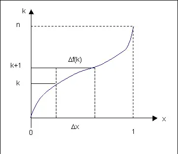

More than a full answer, this is a first step in looking for a solution.
P_Inv_Bin_1
Consider a function $f(k)$ such that $$ \Delta \,f(k) = \Delta \,x = \left( \matrix{ n \cr k \cr} \right)p^{\,k} \left( {1 - p} \right)^{\,n - k} $$
That is precisely the Cumulative of the binomial distribution you give $$ C_X (k\,;\,n,p) = \sum\limits_{j = 0}^{k - 1} {\binom{n}{j} p^{\,j} \left( {1 - p} \right)^{\,n - j} } $$
We shall make it continuous in $k$, using
for the sum the Indefinite Sum, i.e.
$$ \eqalign{ & \Delta F(x) = F(x + 1) - F(x) = f(x)\quad \Rightarrow \cr & \Rightarrow \quad F(x) = \Delta ^{\, - 1} f(x) = \sum\nolimits_{\;j = 0}^{\;x} {f(j)} \cr} $$
So we write $$ C_X (k\,;\,n,p) = \left( {1 - p} \right)^{\,n} \sum\nolimits_{\;j = 0}^{\;k} {\binom{n}{j}\left( {{p \over {1 - p}}} \right)^{\,j} } $$
The floor of its functional inverse (in $k$) is then the function you are looking for.
But unfortunately there is no close expression available for the partial sum on the lower index of a binomial.
