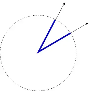

Consider a plane restricted to two rays from the origin, with a "ball" centered at the origin:
Metric space restricted to two rays with ball at the origin
Nowhere in this ball can you find two points farther apart than the radius of the ball.
