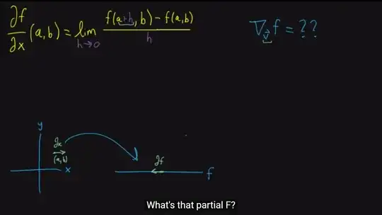

In the multivariable world, differentials are more diverse. Instead of having only one dimension in which to nudge the input value of a function, we can take an indefinitely small step in an infinite number of directions, a prime candidate being ∂x, a tiny nudge in the direction of the x-axis, as shown.
Similarly, $∂y$, $∂z$, etc., represent nudges parallel to the relevant input axes. However, the formula one comes across for the differential of $f$ in multivariable calculus is interesting.
