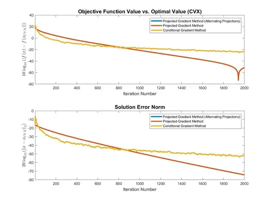

So I wrote a MATLAB Code which is accessible in my StackExchange Mathematics Q2935650 GitHub Repository.
The solvers I implemented / used are as following:
  1. CVX as a reference.
  2. Projected Gradient Descent with Projection onto the Unit Simplex as I implemented in Orthogonal Projection onto the Unit Simplex.
  3. Projected Gradient Descent with Projection onto the Unit Simplex implemented as Alternating Projections for the projection of the intersection of 2 convex sets. See Projections onto Convex Sets and How to Project onto the Unit Simplex as Intersection of Two Sets (Optimizing a Convex Function).
  4. Conditional Gradient Method (Frank Wolfe Algorithm).
The results are given by:
Timing for handling your case of $ A \in \mathbb{R}^{1500 \times 500} $ is less than a second in either of the methods I implemented.
