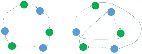

Now, we can show that the parity (oddness/evenness) of the number of cycles is invariant under the sliding of the tile. To see why, we only need to consider vertical moves, because horizontal moves preserve the permutation. Here, notice that exactly $3$ elements $x, y, z$ change position to $z, x, y$ or $y, z, x$. The two cases are analogous- just reverse the arrows in the cycle- so we'll just deal with the $z, x, y$ case here. We proceed by focusing on the predecessors of $x, y, z$ in their respective cycles. Now there are $3$ cases to consider:
  • Same cycle: All elements are in the same cycle. In this case, exactly one cycle remains in the place of the old cycle, so the total number of cycles is preserved. See the image below for this case. Green circles represent predecessors, blue circles represent $x, y, z$. Dotted lines from blue to green denote a sequence of 0 or more elements, including the green i.e. the blue might equal the next green. Similar pictures for the other cases can be drawn.
