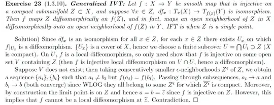

I have found an answer for this question on the internet in page 8 in the following link:
https://math.berkeley.edu/~ceur/notes_pdf/Eur_GPDiffTopSolns.pdf
But I could not understand (imagine) the second paragraph of the solution given in the image below:
Could anyone explain this for me please?
Also in the second line in the solution I do not know why he take the intersection on $U_{i}'s$ and not the union?Could anyone explain this for me please?

OK, let's break the exercise into steps. First, the "then $f$ maps $Z$ diffeomorphically onto $f(Z)$" part.
Since you have that $f$ in one-one on $Z$, and immersion at every $x\in Z$, you only need to prove that the map $f|_Z: Z \rightarrow f(Z)$ is a proper map, because then it would be an embedding, and an embedding is a diffeomorphism onto its image (pages 17, 18). Just take a compact $K \subset f(Z)$, since $f(Z)$ is given the subspace topology, it is also compact in $Y$, and since $Y$ is Hausdorff, it is closed in $Y$. Then since $f|Z$ is continuous as a map with image in $Y$ (just the restriction of a continuous map), $f^{-1}(K)$ is closed in $Z$, but $Z$ compact implies it is compact in $Z$. So $f$ is also proper, hence a diffeomorphism.
Now, we need to prove that $f$ is a little more, is a diffeomorphism of an open neighborhood of $Z$ in $X$ onto an open neighborhood of $f(Z)$ in $Y$.
Why is it that it's enought to prove $f$ to be one-one is an open neighborhood of $Z$ in $X$ (Exercise 5)? Because Exercise 5 tells you that a local diffeomorphism that is one-one is actually a diffeomorphism. Suppose you find an open nighborhood $U$ of $Z$ in $Y$ with $f|_U$ one-one, we could (if necessary) intersect $U$ with a neighborhood $V$ of $Z$ such that $f|V$ is a local diffeomorphism (this $V$ you get it by just taking a finite union of neighborhoods in $X$ of points in $Z$ restricted to wich $f$ is a diffeomorphism, local condition). Then you can assume there's a $U$ neighborhood of $Z$ in $X$ such that $f|_U: U\rightarrow f(U)$ is a local diffeo and one-one, applying Exercise 5 we get that $f|_U$ is a diffeomorphism.
There are only two things left to prove: Exercise 5, and the injectivity in a neighborhood of $Z$ in $X$.
For the first one, just observe that if $f: A\rightarrow B$ is a one-one local diffeo, then exists $f^{-1}: f(A)\rightarrow A$ and both $f$, $f^{-1}$ are smooth by just using their local expression, the identity. Then $f$ is a diffeomorphism onto its image, that hence is going to be open in $B$.
For the second one, suppose $f$ is not one-one restricted to any neighborhood of $Z$ in $X$.
Define $U_n=$ {$x \in X| d(x,Z)<\frac{1}{n}$} (your manifold X is sitting inside some $\mathbb{R}^k$ by definition, and if you don't take Guillemin's convention, just use Whitney's Embedding Theorem). There are {$a_n$}, {$b_n$} such that $a_n, b_n \in U_n$ and $f(a_n)=f(b_n)$. Clearly $d(a_n, Z), d(b_n, Z)$ tend to zero. Since the distance is continuous and $Z$ is closed in $X$ (again $Z$ compact inside $X$ Hausdorff is closed), then there are $z_1, z_2\in Z$ with $z_1=\lim_{n\to\infty} a_n$, $z_2=\lim_{n\to\infty} b_n$. Since $f$ is continuous, $f(z_1)=f(z_2)$. This contradicts the injectivity of $f$ restricted to $Z$ if $z_1\neq z_2$. So that $z_1=z_2=z$.
Now that contradicts the fact that $df_z$ is an isomorphism, since this implies that there's a neighborhood of $z$ in $X$ restricted to which $f$ is a diffeomorphism, in particular one-one.

  • why $Y$ is hausdorff? – Intuition Sep 20 '18 at 16:13
    your answer is really wonderful thank you so much – Intuition Sep 20 '18 at 16:23
    You are welcome. We are here to help! As for the Hausdorff-ness, most authors require the Hausdorff condition to avoid horrendous examples. For example see https://math.stackexchange.com/questions/472998/why-do-we-need-hausdorff-ness-in-definition-of-topological-manifold I'm sure, although in the book is not required, that neither Guillemin nor Pollack are going to be mad at you if you assume this property. ;) – Laz Sep 20 '18 at 16:32
  • I could not understand in your answer why $f(Z)$ is given the subspace topology?and why it is compact in $Y$? could you explain this for me please? – Intuition Sep 23 '18 at 10:21
  • Does not this question answer the first part ? https://math.stackexchange.com/questions/2922714/first-generalization-of-the-inverse-function-theorem-q-10-section-1-3-in-allan-p?rq=1 – Intuition Sep 23 '18 at 11:18
  • okay for the second part of my first comment today ....I knew the answer continous image of a compact set is compact...... for the first part I think because it is a submanifold ...... am I correct? – Intuition Sep 23 '18 at 15:07
    Well, throughout the chapter, the authors never specify a topology for the image $f(X)$ of an immersion $f: X \rightarrow Y$, and they use the fact that it has a topology (e.g. the theorem in page 17). I think it's customary in topology, that whenever not specified a topology for a subset and used, it's going to be the inherited one.
    You can't say it is the subspace topology because it is a submanifold, because to prove it is a submanifold you use some topology on it.
    For the compactness of $f(Z)$, you are right.
    I think this question is the same as that you reference.
    – Laz Sep 23 '18 at 16:09
  • your answer is thorough, precise and elegant but is the other answer also correct? – Intuition Sep 23 '18 at 16:17
  • what is the importance of $f(Z)$ being closed in $Y$ in the first part? – Intuition Sep 23 '18 at 20:05
  • I understood it thank you – Intuition Sep 23 '18 at 20:28
