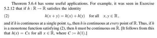

Context:
Sec. 5.6 (in fact immediately after Theorem 5.6.4) in the book Introduction To Real Analysis by Robert G. Bartle & Donald R. Sherbert, 4th edition.

(edit) I note the relevant portions of the book,
and,
it seems that $(a)$ you misread the book, which says you only need to prove continuity at one point, and $(b)$ you want a proof that first proves continuity, and then appeals to the known result(Exercise 5.2.12), i.e. that a function with property $(2)$ that is also continuous at one point is of the form $cx$. But as you showed, there are only countably many discontinuities, and $\mathbb R$ is uncountable. So $f$ is continuous somewhere, and we're already done.
As a final remark, note that continuity at any one point $x$ immediately implies continuity at any other point $y$, since if $y_n\to y$ then $x_n := y_n - y + x \to x$ and the additive property $(2)$ implies that $$ f(y_n) = f(x_n) + f(y) - f(x) \to f(y).$$ Therefore the known result used above follows from the basic result for continuous functions with property $(2)$.

  • Sir, I get your answer Upto $f(x)=xf(1)$ for every $x\in\mathbb{R}$. But from this, how Continuity of $f$ on $\mathbb{R}$ is proved? Where you had used additive property? Please elaborate. – Akash Patalwanshi Dec 01 '20 at 03:46
    @AkashPatalwanshi, this was years ago, but $f(x) = cx$ looks like a continuous function to me? – Calvin Khor Dec 01 '20 at 04:26
  • yes sir. But where "Theorem 5.6.4" and "Exercises 5.2.12" is used? – Akash Patalwanshi Dec 01 '20 at 04:40
  • Is am i correct? as $f$ is monotone on $\mathbb{R}$ and hence by 'Theorem 5.6.4' set of points $D\subseteq\mathbb{R}$ at which $f$ is discontinuous is countable set but $\mathbb{R}$ is uncountable and hence there exists some point in $\mathbb{R}$ at which $f$ is continuous and hence by 'Exercise 5.2.12' we have $f$ is continuous on $\mathbb{R}$. – Akash Patalwanshi Dec 01 '20 at 04:42
    @AkashPatalwanshi That is exactly what I said 2 years ago, I think – Calvin Khor Dec 01 '20 at 04:46
  • thank you sir, I confused by point (a) in your answer. – Akash Patalwanshi Dec 01 '20 at 04:52
    @AkashPatalwanshi I am not sure I understand you. Point $(a)$ was specific to the OP (Saaqib). He didn't understand the book, which was outlining the above proof. I still don't know if Saaqib understood me; he didn't accept my answer. You don't need to read $(a)$. – Calvin Khor Dec 01 '20 at 04:55
