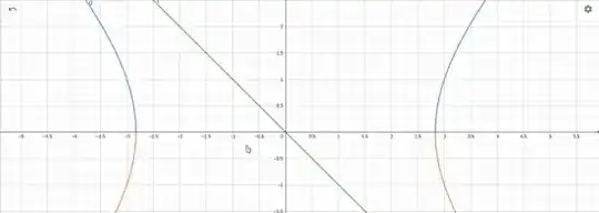

To be able to compute the roots of $3^{2x} + k3^x +2$ with respect to $3^x$ you have immediately the condition $k^2 - 8 \geq 0$. So $k\leq -2\sqrt{2}$ or $k\geq 2\sqrt{2}$. In case of either equality, you have zero discriminant.
You must also meet the condition $$-k \pm \sqrt{k^2-8} > 0. $$ This leaves you with $k < -2\sqrt{2}$.
Solving analytically the inequality $-k \pm \sqrt{k^2-8} > 0$ can be prone to mistakes so make sure to double check.
When in doubt, I can always use my rudimentary geogebra skills to draw a picture and get a feeling for what's going on. The green line is $f(x) = -x$ and blue and red lines are $g(x) = \sqrt{x^2-8}$ and $h(x) = -g(x)$ respectively.
