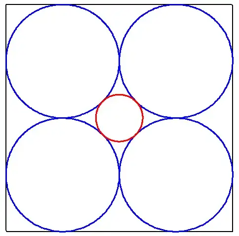

I also don't know about the list, but this simple geometric construction might be there. I remember it being attributed to Vitali Milman.
  • Divide $n$-dimensional cube $Q$ into $2^n$ equal cubes in the natural way;
  • Inscribe a ball in each of these $2^n$ cubes;
  • There is some room left at the center of $Q$; inscribe a ball there.
This is how it works in two dimensions: $Q$ is the black square.
example
You can imagine a similar $3$-dimensional picture with $8$ blue balls and a small red one in the middle.
The red ball is contained in $Q$ when $n\le 9$, but not when $n\ge 10$.
