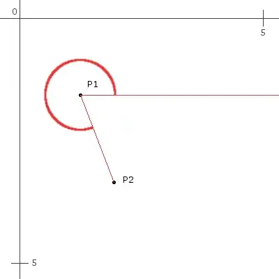

As depicted below, P2 and P1 would be the 2 points, with the angle (Thick red line) goes from the horizontal +x axis, to the line P1P2.
angle diagram

  • Since the angle is given by an inverse trig function, any method you develop to calculate it will be equivalent to a method to calculate inverse trig functions. So I think what you are really asking is, how to calculate inverse trig functions when they are not built-in? And I think the usual answer to that is taking part of an infinite series. – Gerry Myerson Jan 27 '13 at 01:22
  • I don't see why you cannot use a trigonometric inverse function. They are usually implemented, and if not, you can define them easily as series... http://en.wikipedia.org/wiki/Trigonometric_functions Since trigonometric series usually converge fast enough, it will probably take less time to calculate the value than to search it in a table. – Beni Bogosel Jan 27 '13 at 01:23
  • A good programmer never reinvents the wheel. I know that it is an option to use the pre-built function, but it will be very costly. I need to do up to (at max) 100 of these calculates per 17 milliseconds. If they exceed 170 nanoseconds each (Which is almost a guarantee) then the frames per seconds will drop quite a bit. – Obicere Jan 27 '13 at 01:25
  • How can I calculate the between 2 <- Calculate the what? – hjpotter92 Jan 27 '13 at 01:25
