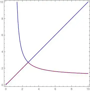

Attached a plot for $x^y = y^x$ (blue) with the superimposed plot for $y = -x W\left(-\frac{\ln x}{x}\right)/\ln x$ (dashed red)
