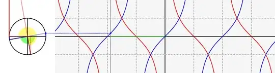

Just as a visual complement for the answers you already have, notice the following animation.
Green angle: $\theta$, yellow angle: $\pi/2 - \theta$ and $\cot(x)$ is the red curve.
For more details regarding these types of constructions, see this question.
