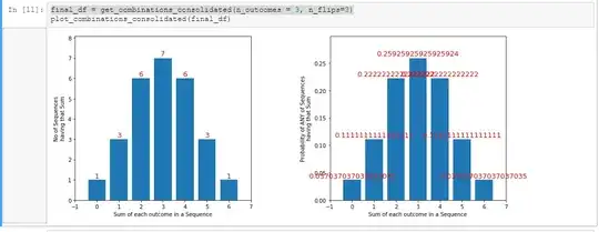

Below is when I throw dice with 3 outcomes (0,1,2), 2 times. I get $[1,2,3,2,1]$ as the frequency of sequence as you see on LHs of the diagram.
Below is when I throw dice with 3 outcomes (0,1,2), 3 times. I get $[1,3,6,7,6,3,1]$ as frequency of sequence.
I have generated these, by directly generating all possible combinations and counting. When n is large, computing time is exponentially large. So I want a formula shortcut to come up with these frequency values pro grammatically. This is why above question.
