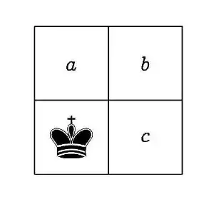

Just to illustrate, let me show you the solution for a $2\times 2$ chessboard:
a small board
The expected time to cover the other 3 squares ${a,b,c}$ is equal to $$\mathbb{E}(T_{a})+\mathbb{E}(T_{b})+\mathbb{E}(T_{c})-\mathbb{E}(T_{a,b})-\mathbb{E}(T_{a,c})-\mathbb{E}(T_{b,c})+\mathbb{E}(T_{a,b,c})$$
Standard Markov chain theory uses linear algebra to find these expected hitting times $$\mathbb{E}(T_{a})=\mathbb{E}(T_{c})=3, \mathbb{E}(T_{b})=4, \mathbb{E}(T_{a,b})=\mathbb{E}(T_{b,c})=2, \mathbb{E}(T_{a,c})=\mathbb{E}(T_{a,b,c})=1$$
Putting it all together, we find that the expected cover time is $3+3+4-2-2-1+1=6$.
Note that I counted the king's initial position as already covered. If you require a return to your starting point you can modify the above technique.
