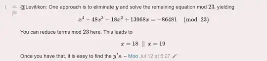

This: $$x^4 + 21x^3 + 5x^2 + 7x + 1 \equiv 0 \mod 23$$
Leads to: $$x = 18 || x =19$$
I know this because of this WolframAlpha example and because a fellow member posted it in a since deleted & related question.
What I don't understand are the steps involved in arriving at x = 18 || x = 19 from this equation.
My question starts with the reduced terms mod 23 example in the linked question. I'm now trying understand how to reduce this equation to x = 18 || x = 19.
