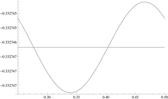

The function given in $(4)$ for $x=2^{-2^{-t}}$ has period $1$ in $t$. I have computed $f(1)$ from $(4)$ for $x\in\left[\frac14,\frac12\right]$; that is, the full period $t\in[-1,0]$. I get a plot very similar to that of Michael:
which oscillates between $-0.33274775$ and $-0.33274460$. The horizontal line is $$ \frac12-\frac\gamma{\log(2)}=-0.33274618 $$ which is pretty close to the average of the minimum and maximum.

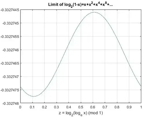

  • When you integrate (4), you average over the possible values of $f(1)$. My graph says $f(x)$ oscillates near $x=1$ with amplitude 0.0000015. Is that true, or a numerical artifact of underflow ? – Empy2 Jul 29 '18 at 07:32
  • @Michael: if we differentiate $(3)$, and evaluate as $x\to1^-$, we get $f'(1)=\frac1{2\log(2)}-1$; so the function apparently decreases to $\frac12-\frac\gamma{\log(2)}$ as $x\to1^-$. – robjohn Jul 29 '18 at 12:09
  • The periodicity is that $f(x)=p(x)+q(x)$ where $q(x)=q(x^2)$, for example $q(x)=\sin(2\pi\log_2(-\log(x)))$. So $q(x)$ is cancelled in (3), which therefore can't rule out $q(x)$ – Empy2 Jul 29 '18 at 12:24
  • @Michael: ah, yes. I have encountered this before, and I was worried about it because of $(4)$. Equation $(3)$ kills the effect of any such $q$. I will have to think on this and try to see if I can compute this component. – robjohn Jul 29 '18 at 12:36

Let $\ f(x) := \log_2(1-x) + \sum_{n=0}^\infty x^{2^n}, \ $ $\ g(x) := f(e^{-x}) = \log_2(1-e^{-x}) + \sum_{n=0}^\infty e^{-x2^n}, \ $ and $\ a_k := g(2^{-k}) = b_k + \sum_{n=0}^\infty e^{-2^{n-k}} \ $ where $\ b_k := \log_2(1-e^{-2^{-k}}) \approx -k - 2^{-1-k}/\log(2). \ $ Now $\ \sum_{n=0}^\infty e^{-2^{n-k}} = \sum_{n=1}^k e^{-2^{-n}} + B \ $ where $\ B := \sum_{n=0}^\infty e^{-2^n} \approx 0.521865938459879089046726. \ $ But $ c_k :=\! -k \!+\! \sum_{n=1}^k e^{-2^{-n}}\! = \sum_{n=1}^k \big(e^{-2^{-n}}\!-\!1 \big) \ $ and $\ c_k \to C \ $ where $\ C \approx -0.8546133208927. \ $ Finally, $\ \lim_{x\to 1^-} f(x) = \lim_{x\to 0^+} g(x) = \lim_{k\to\infty} a_k = B+C \approx -0.3327473824328992250.\ $ The digits of $1$ minus this number is OEIS sequence A158468. $f(\exp(-2^{-30})) \approx -0.3327473822.$
EDIT: Unfortunately, it seems that the function $\ f(x) \ $ oscillates as it gets close to $1$ from below. That is, $\ g(2^{-x}) \ $ approaches a period $1$ function with mean value $\ 1/2 - \gamma/\log(2) \ $ with oscillations of magnitude $\ \approx 1.57315\times 10^{-6} \ $ as Michael shows. Thus, the limit does not exist. It was obvious that the infinite sum in $\ f(x) \ $ has radius of convergence $1.$ What was not obvious was the limiting behavior as $\ x\to 1^-. \ $ We now know that the series has a logarithmic singularity and $\ f(x) \ $ is what remains. That $\ f(x) \ $ has interesting oscillatory behavior is nice information.
