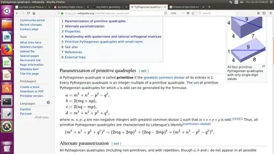

It really is a four variable parametrization, coming from quaternion multiplication. The attribution in wikipedia is to the number theorist V. A. Lebesgue. He did publish on this in the 1850's. However, this was surely known to Euler.
Discussed in detail in Pall 1940
