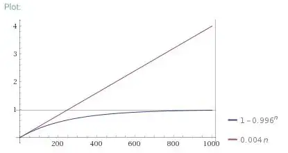

I think that the easiest way for you to grasp where the 'missing' successes went is actually mostly in multiple successes.
If one event has 0.2 probability of success, twice the event has probabilities:
  • 0.64 -> no success at all (0.8*0.8)
  • 0.04 -> two successes (0.2*0.2)
  • 0.32 -> one success
Therefore, relatively high probabilities and small number of trials means success rate is not at all being proportional to number of trials.
On the other hand, if you have a very low probability of success, then probability of at least one success is approximately proportional to number of trials.
The graph below maybe illustrates this better than my words, but since probability of success is very low (for instance, 0.4%) then probability of two or more successes is A LOT lower (0.0016%, 0.000064%, etc., so basically negligible) so if several experiments are repeated total success rates will closely match the number of times, on average that 'one' success occurs.
Probability for at least one success with probability of 0.004, for 1 to 1000 tries (straight approximation, actual curve):
