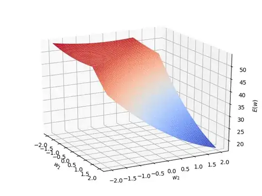

The answer is no: consider a very simple network with two inputs (and a bias $b=1$) and one output. Suppose we have just one input pattern (i.e. $|D|=1$), which is the vector $x=(1,\ 1)$. Suppose the desired (target) output is $t=10$. The network is parameterized by the weight vector $w=(w_1,\ w_2)\in\mathbb{R}^2$. If we take $\lambda=1$, the error function is given by
\begin{align*} E(w)&=\frac{1}{2}\big(t-\max\{w^\text{T}x+b,0\}\big)^2+\frac{1}{2}\lambda\|w\|^2\\ &=\frac{1}{2}\big(10-\max\{w_1+w_2+1,0\}\big)^2+\frac{1}{2}(w_1^2+w_2^2). \end{align*}
However, we can plainly see that this function is not convex:
Non-convex error surface for simple neural network
