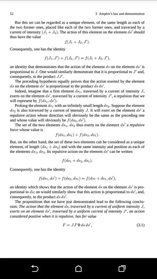

The application of this theorem is in the last part of page 52 (second page of the chapter)
enter image description here enter image description here enter image description here

  • Thank you very much for the answer... (1) Can you please give a reference to a proof of this theorem if it is not that much intricate for a physics graduate student. (2) How can a function be discontinuous at every point. It seems impossible for me to imagine such a function. – Joe Jul 19 '18 at 15:09
  • I haven't yet studied bounded and Lebesgue measurable functions in my course. – Joe Jul 19 '18 at 15:18
  • I have read the Wikipedia article and now I understand how a function can be discontinuous at every point. Can you show me in my problem (page 52) that the function under consideration is not discontinuous at every point. – Joe Jul 19 '18 at 17:45
  • @Joe I've edited the question with info about your comments. I don't know physics, so I think you may have more luck with your quetion about page $52$ on physics stackexchange or electrical engineering stackexchange https://physics.stackexchange.com/ https://electronics.stackexchange.com/ – Ovi Jul 19 '18 at 17:58
