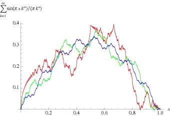

but there are other examples, like the van der Waerden functions, or the Faber functions. Most of these "look like" some variation of:
Weierstrass Function from Wolfram.
(Weierstrass functions from Wolfram)
Specifically, they are clearly not invertible. Since these functions are generally self-similar at many scales, this non-invertability would seem to hold essentially everywhere.
