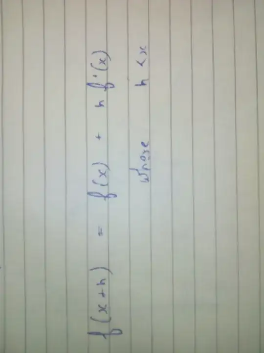

Well you can use the taylor series or you can use an approximation which I am suggesting, but it will be only useful if you know the value of sin of some nearby anglesh is very less than x
  • Worth elaborating. Use various well known values, plus identities to get values for an angle as near as possible. Then an approximation apporach such as Taylor can converge rapidly and be practical. – Keith Jul 16 '18 at 21:44
