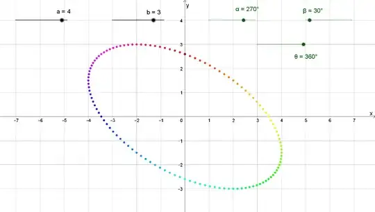

  • The curve is known as Lissajous figure (with same frequencies).
  • The area bounded by the ellipse is $A=\pi ab\sin (\beta-\alpha)$.
  • $A>0$ gives anti-clockwise trace whereas $A<0$ for clockwise.
  • When the curve degenerates to a line segment, $A=0$
