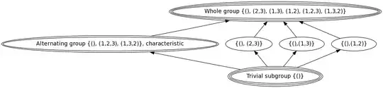

The subgroup structure of $S_3$ is described here, including this somewhat Enterprise-esque diagram:
subgroup structure of S_3
Let's denote the subgroups by $S_3$, $A_3$, $T_1$, $T_2$, $T_3$ and $I$ (from top to bottom and from left to right). Using the superset relation $\supseteq$ as the partial order $\le$, we can find the required values of the Möbius function using Aigner's Proposition $5.4$:

\begin{eqnarray*} \mu(S_3,S_3)&=&1\;,\\ \mu(S_3,A_3)&=&-1\;,\\ \mu(S_3,T_i)&=&-1\;,\\ \mu(S_3,I)&=&3\;. \end{eqnarray*}

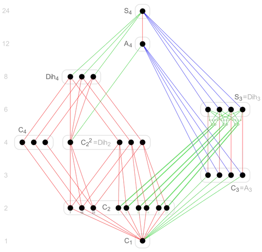

The subgroup structure of $S_4$ is analyzed here, including this amazing diagram:
(Attribution for the diagram: By Watchduck (a.k.a. Tilman Piesk) - Own work, CC BY-SA 4.0, Link).
Using the diagram's labels for the types of subgroups (but with $D_4$ instead of $\text{Dih}_4$) and distinguishing the left-hand and right-hand types of $C_2^2$ and $C_2$ groups in the diagram by $L$ and $R$, respectively, we find as above:
\begin{eqnarray*} \mu(S_4,S_4)&=&1\;,\\ \mu(S_4,A_4)&=&-1\;,\\ \mu(S_4,D_4)&=&-1\;,\\ \mu(S_4,S_3)&=&-1\;,\\ \mu(S_4,C_4)&=&0\;,\\ \mu(S_4,C_2^{2L})&=&3\;,\\ \mu(S_4,C_2^{2R})&=&0\;,\\ \mu(S_4,C_3)&=&1\;,\\ \mu(S_4,C_2^L)&=&0\;,\\ \mu(S_4,C_2^R)&=&2\;,\\ \mu(S_4,C_1)&=&-12\;.\\ \end{eqnarray*}
Then Möbius inversion from above yields
$$ g_m(S_4)=1-2^{-m}-3\cdot3^{-m}-4\cdot4^{-m}+3\cdot6^{-m}+4\cdot8^{-m}+12\cdot12^{-m}-12\cdot24^{-m}\;. $$
