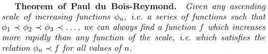

Take a look at Hardy's translation and edition of Du Bois-Reymond's Orders of Infinity, page 10:
Red Banana
  • 23,956
  • 91
  • 192
  • for all functions $\phi_1, \phi_2$ such that $\phi_1 \prec \phi_2$, which are there more of? – Mitch Jul 01 '18 at 23:42
