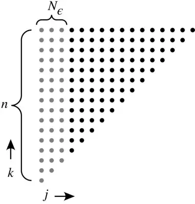

If $$ \lim_{n\to\infty}\frac{a_n\,a_{n+2}}{a_{n+1}^2}=L^2\tag1 $$ then for any $\epsilon\gt0$, there is an $N_\epsilon$ so that for $n\ge N_\epsilon$, $$ \left|\,\log\left(\frac{a_n\,a_{n+2}}{a_{n+1}^2}\right)-2\log(L)\,\right|\le\epsilon\tag2 $$ Note that $$ \begin{align} \frac1{n^2}\sum_{k=0}^{n-1}\sum_{j=0}^{k-1}\log\left(\frac{a_j\,a_{j+2}}{a_{j+1}^2}\right) &=\frac1{n^2}\sum_{k=0}^{n-1}\log\left(\frac{a_0}{a_k}\frac{a_{k+1}}{a_1}\right)\\ &=\frac1n\log\left(\frac{a_0}{a_1}\right)+\frac1{n^2}\log\left(\frac{a_n}{a_0}\right)\tag3 \end{align} $$ Inspired by the following diagram
We can break down the sum on the left side of $(3)$ as follows $$ \begin{align} \frac1{n^2}\sum_{k=0}^{n-1}\sum_{j=0}^{k-1}\log\left(\frac{a_j\,a_{j+2}}{a_{j+1}^2}\right) &=\frac1{n^2}\sum_{k=N_\epsilon}^{n-1}\sum_{j=N_\epsilon}^{k-1}\overbrace{\log\left(\frac{a_j\,a_{j+2}}{a_{j+1}^2}\right)}^\text{within $\epsilon$ of $2\log(L)$}\\ &\color{#C00}{+\frac{n-N_\epsilon}{n^2}\sum_{j=0}^{N_\epsilon-1}\log\left(\frac{a_j\,a_{j+2}}{a_{j+1}^2}\right)+\frac1{n^2}\sum_{k=0}^{N_\epsilon-1}\sum_{j=0}^{k-1}\log\left(\frac{a_j\,a_{j+2}}{a_{j+1}^2}\right)}\tag4 \end{align} $$ For any $\epsilon\gt0$, the red terms vanish as $n\to\infty$. The remaining term on the right hand side is $\frac1{n^2}$ times a sum of $\frac{(n-N_\epsilon)^2+(n-N_\epsilon)}2$ terms, all within $\epsilon$ of $2\log(L)$.
Therefore, $$ \left|\,\lim_{n\to\infty}\frac1{n^2}\sum_{k=0}^{n-1}\sum_{j=0}^{k-1}\log\left(\frac{a_n\,a_{n+2}}{a_{n+1}^2}\right)-\log(L)\,\right|\le\frac\epsilon2\tag5 $$ Since $(5)$ is true for any $\epsilon\gt0$, we have $$ \lim_{n\to\infty}\frac1{n^2}\sum_{k=0}^{n-1}\sum_{j=0}^{k-1}\log\left(\frac{a_n\,a_{n+2}}{a_{n+1}^2}\right)=\log(L)\tag6 $$ Taking the limit of the right hand side of $(3)$ as $n\to\infty$, we get $$ \lim_{n\to\infty}\frac{\log(a_n)}{n^2}=\log(L)\tag7 $$ which implies $$ \lim_{n\to\infty}\sqrt[n^2]{a_n}=L\tag8 $$
