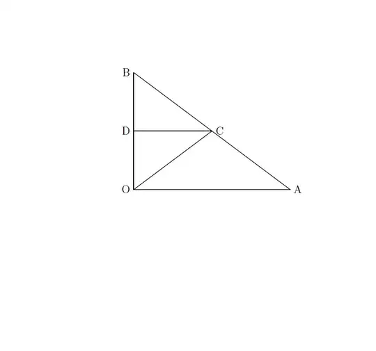

This is not an answer. This is a comment in reply to the great answer of @Chappers above. I am using the answer environment because I do not know how insert a figure inside a comment.
@Chappers Thank you for the great answer.
It does not really matter, but the radius of the circle $C$ is $\frac{1}{2}$ I still believe. Consider the isosceles right triangle with the vertices at the origin $O$, the north pole $\,B (\theta=0, \varphi=0),\,$ and $\,A (\theta=\frac{\pi}{2}, \varphi=0).\,$ Let $A,B\in S$ so that $OA=OB=1$. Let the horizontal line segment $\overline{DC}$ represent a radius in $C$. Since $\theta=\angle COD=\frac{\pi}{4}$ then all the acute inner angles in the figure below are $\pi/4$. So $BC=OC=CD=\frac{1}{2}$.enter image description here

  • Firstly, the radius of the circle $\theta = \pi/4$ is not $1/2$, it's $\cos{(\pi/4)} = 1/\sqrt{2}$.

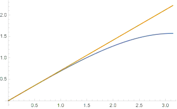

  • Secondly, the circle $\theta=\pi/4$ is not a great circle, so it does not minimise the distance between the two points on the sphere. This is very clear in the case where $\phi_1-\phi_2=\pi$, because then the great circle passing through both points goes through the north pole of the sphere, and the distance along this is $\pi/2$, whereas the distance along $\theta=\pi/4$ is $\pi/\sqrt{2}$ which is rather larger. There's a comparison image of this sort of situation here, with example distances given. And here is a comparison of the great-circle distance (blue) with the "latitudinal" distance (orange) for the case you're considering:
Clearly for small distances the latitudinal distance is a reasonable approximation, but it gets worse and worse for large differences in angle.
