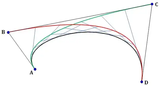

As you said, a quadratic Bezier curve is the envelope of lines whose end-points are moving along two straight lines.
In just the same way, a cubic Bezier curve is the envelope of lines whose end-points are moving along two quadratic curves. You can see this by looking at the last linear interpolation in the de Casteljau algorithm.
And so on. In general, a Bezier curve of degree $m$ is the envelope of lines whose end-points are moving along two curves of degree $m-1$.
Here are the details for the cubic case. Suppose the cubic curve has control points $\mathbf{A}$, $\mathbf{B}$, $\mathbf{C}$, $\mathbf{D}$.
Then its equation is $$ \mathbf{P}(t) = (1-t)^3\mathbf{A} + 3t(1-t)^2\mathbf{B} + 3t^2(1-t)\mathbf{C} + t^3\mathbf{D} $$ In the final step of the de Casteljau algorithm, this is expressed as $$ \mathbf{P}(t) = (1-t)\mathbf{H}(t) + t\mathbf{K}(t) $$ where \begin{align} \mathbf{H}(t) &= (1-t)^2\mathbf{A} + 2t(1-t)\mathbf{B} + t^2\mathbf{C} \\ \mathbf{K}(t) &= (1-t)^2\mathbf{B} + 2t(1-t)\mathbf{C} + t^2\mathbf{D} \end{align} Clearly $\mathbf{H}$ and $\mathbf{K}$ are quadratic Bezier curves, which are shown in green and red respectively in the picture above.
Differentiating the original curve equation, and re-arranging, we get $$ \mathbf{P}'(t) = 2\bigl[(1-t)^2(\mathbf{B} - \mathbf{A}) + 2t(1-t)(\mathbf{C} - \mathbf{B}) + t^2(\mathbf{D} - \mathbf{C}) \bigr] $$ Then, a little algebra confirms that, in fact $$ \mathbf{P}'(t) = 2\bigl[\mathbf{K}(t) - \mathbf{H}(t) \bigr] $$ This shows that the line joining $\mathbf{H}(t)$ and $\mathbf{K}(t)$, which is constructed in the final step of the de Casteljau algorithm, is tangent to the cubic curve $\mathbf{P}(t)$.

  • Thanks for the answer! You write: "You can see this by looking at the last linear interpolation in the de Casteljau algorithm." How can I see this? I can see that the higher-order Bézier curve is traced out by points on these lines -- but how can I see that it's the envelope of these lines? – joriki Jul 20 '18 at 15:54
  • Because the lines are all tangent to the final curve – bubba Jul 20 '18 at 16:34
  • Thanks for the nice graphic! I was apparently very unclear in formulating this question, as it keeps getting misunderstood :-) (This also happened with the deleted answer.) I'm aware that the property of being an envelope is characterized by the lines being tangent to the curve. I can also see that the lines appear to be tangent to the curve here. What I was after was a way to "see" this in the sense of proving it, not in the sense of looking at appearances on diagrams (as nice as they are). – joriki Jul 21 '18 at 05:10
  • The tangency is a basic property of the de Casteljau algorithm. In fact, one of the nice things about the de Casteljau algorithm is that it gives you a point and first derivative vector from the same calculations. A little algebra shows that the first derivative of the curve at parameter value $t$ is parallel to the line constructed in the final step of the de Casteljau algorithm. I can write out the details, if you want, but I'm sure you could do the calculations yourself. – bubba Jul 21 '18 at 07:05
  • There's an explanation here: https://pages.mtu.edu/~shene/COURSES/cs3621/NOTES/spline/Bezier/bezier-der.html – bubba Jul 21 '18 at 07:08
