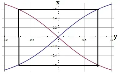

If for example you plug in $ y= \pm \dfrac 34$ you get $ x= \pm \dfrac 35$ and in total there are four correct cases possible as shown below; we can choose the sign in each case,i.e., from each quadrant depending on quadrant context.
All algebraic operations here are reversible.

  • But $y=-3/4$, $x=3/5$ doesn't satisfy the original equation. – Gerry Myerson Jun 09 '18 at 08:51
  • Did I understand correctly? When evaluating $x$ for given $y$ the fraction has a plus or minus sign in the denominator due to sqrt sign in $\sqrt {1+y^2} $ from which positive sign only needs to be taken. – Narasimham Jun 09 '18 at 09:03
  • "All algebraic operations here are reversible." - how so? The solution set of the squared equation and the original equation are different. By "reversible operation", I meant that it would produce an equivalent equation, i.e. an equation with the same solution set. – Pig Jun 10 '18 at 11:28
  • The . $ \sqrt{..}$ admits/includes by implication what appears to be an extraneous or spurious solution. – Narasimham Jun 13 '18 at 18:47
