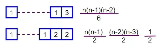

Consider $S(n,n)$ : How many ways can we split the set $[n]$ into $n$ (non empty) blocks ? Each block will contain one element and so there is one way to do this. $S(n,n)=1$
Consider $S(n,n-1)$ : How many ways can we split the set $[n]$ into $n-1$ (non empty) blocks ? Each block will contain one element apart from the last block that will contain $2$ elements, how many ways can we choose two elemnts from $[n]$ ? So $S(n,n-1)=\frac{n(n-1)}{2}.$
Now consider $S(n,n-2)$ there are two possibilities enter image description here
Add these quantities and you will have the result.
