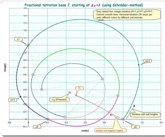

Late update: here is a picture showing fractional iteration based on the Schroeder/Koenigs-solution for the tetration.
The start is taken for $z_0=1$ and from this it is tetrated with real heights from $z_0$ to $z_7$ giving the nearly spiral trajectory towards the (first) fixpoint $z_\infty$.
Iteration with (purely) imaginary heights follow the red line direktly from $z_0$ to $z_\infty$ The point which is arrived at after iteration "$î$ times" is marked as $z_î$ (near the fixpoint at the end of the red line) image
