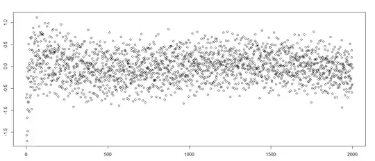

$z_j-Z_j$
The above observation should heuristically follow from this observation which is based on data:
There exists a $K_0 \in \mathbb{N}$ such that for each $K \ge K_0$ there exist real numbers $a_{K,1}, a_{K,2},\cdots,a_{K,K},b_{K,1}, b_{K,2},\cdots,b_{K,K}$ such that for all $n \in \mathbb{N}$ we have:
$$ z_n = \epsilon_K+\sum_{k=1}^K a_{K,k} n^{b_{K,k}}$$ $$ \epsilon_K \equiv N(0,\sigma_K^2)$$ $$ \lim_{K \rightarrow \infty} \sigma_K = 0$$
Then taking the limit $K \rightarrow \infty$ we should heuristically get $\lim_{K \rightarrow \epsilon} \epsilon_K = 0$, since the expectation of $\epsilon_K$ is $=0$ and the variance of $\epsilon_K$ goes in the limit to $0$, and hence heuristically the above stated infinite sum should be true.
I have computed with the code above example values for $K=1,2,3$ using the nls function in R. It would be nice, if someone knows another package in R or Python to estimate the $a_k,b_k$ if he or she tells me of that package, since with nls I don't think one can do more than 6 parameters (K=3), or at least I haven't figured out how, if it is possible.
Heuristically this cannot be true if the sum is finite. In particular it is well known that $z_n\approx 2\pi n/\log(n)$, whereas any finite sum above will ultimately grow like $j^B$, where $B=\max_i b_i$.
It is however interesting that this seems to work locally beyond just a few terms, so feel free to post some plots of $z_i-Z_i$ to study this further.
