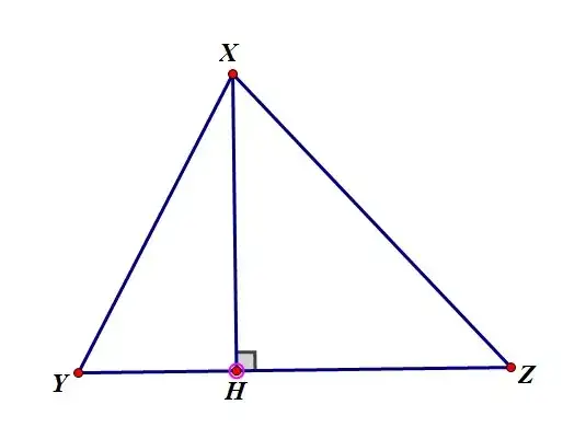

Suppose a triangle $XYZ$ with sides $a=13$, $b=15$ and $c= 14$. We have to find a perpendicular to side $c$ passing from point $X$.
Image Link : https://i.stack.imgur.com/dmFSL.jpg

But by Pythagoras theorem :-
$H ^2 = P^2 + B^2$
Now let's suppose our expected answer is $d$ then (Refer image above ),
$(a+b)^2 = (2d)^2 + c^2$
$28 ^2 = (2d)^2 + 14^2$
$784 = 4d^2 + 196$
$4d^2 = 784 - 196$
$d^2 = 147$
$d = \sqrt{147}$
Which is not equal to $12$ Which proves inaccuracy

  • The triangle is a 5-12-13 triangle next to a 3-4-5 traingle scaled up to 9-12-15, with the 12 as the common side. – Peter Phipps May 13 '18 at 17:45
    Where did you get $(a+b)^2=4d^2+c^2$? I'm still trying to figure out how you got to that. The sides $a$ and $b$ don't seem like the hypotenuse, which is what I assume you referred as in the formula $H^2=P^2+B^2$ – Frank W May 13 '18 at 17:46
  • $H$ is the height of the $5,12,13$ left side of your triangle and also the height of the $9,12,15$ right side of your triangle. But your $H^2=P^2+B^2$ formula treats $H$ as the hypotenuse of some triangle which does not appear in your diagram. What is this $HPB$ triangle? – John Wayland Bales May 13 '18 at 17:46
  • @JohnWaylandBales I think Ritanshu is using $H^2=P^2+B^2$ as the $\text{hypotenuse}^2=\text{perpendicular}^2+\text{base}^2$ instead of it as points, it would make more sense IMO. But their next step confuses me. – Frank W May 13 '18 at 17:49
Here's what you mean:
You said:
$(a+b)^2=(2d)^2+c^2$
$\Leftrightarrow (XY+XZ)^2=(XH+XH)^2+(HY+HZ)^2$
$\Leftrightarrow XY^2+XZ^2+2XY.XZ=XH^2+XH^2+2XH^2+HY^2+HZ^2+2HY.HZ$
$\Leftrightarrow XY^2+XZ^2+2XY.XZ=(XH^2+HY^2)+(XH^2+HZ^2)+2(XH^2+HY.HZ)$
$\Leftrightarrow XY^2+XZ^2+2XY.XZ=XY^2+XZ^2+2(XH^2+HY.HZ)$
$\Leftrightarrow XY.XZ=XH^2+HY.HZ$
This equality obviously is not true for $XH=12;XY=13;XZ=15;HY=5;HZ=9$, because it is impossible to prove the last equality in general, which means it is false.

The inaccuracy is, unfortunately, yours. The step $(a+b)^2=(2d)^2+c^2$ is not a proper way of handling the Pythagorean relations.
If the altitude (of length $d$) separates the base into parts $p$ and $q$, then Pythagoras lets us write $$a^2 = d^2 + p^2 \qquad\text{and}\qquad b^2 = d^2 + q^2 \tag{1}$$ We can use the relation $p+q=c$ to combine these into an equation that allows us to solve for $d$.
Your error, I believe, was in attempting to combine the squared elements in $(1)$, term-by-term: $$(a+b)^2 = (d+d)^2 + (p+q)^2 \qquad(\text{error!})$$ This would be a very convenient algebraic trick, if it worked; but it doesn't. For example, $$5^2=3^2+4^2 \qquad 13^2=5^2+12^2 \qquad\text{but}\qquad \underbrace{(5+13)^2}_{324}\neq\underbrace{(3+5)^2+(4+12)^2}_{320}$$
Instead, we have to work quite a bit harder. We can start by replacing $q$ in $(1)$ with $c-p$: $$\begin{align} b^2 &= d^2 + (c-p)^2 \tag{2}\\ &= d^2 + c^2 + p^2 - 2 c p \tag{3}\\ &= d^2 + c^2+(a^2-d^2) - 2 c p \tag{4}\\ &=a^2 + c^2 - 2 cp \tag{5}\\ 2 cp&= a^2 -b^2 + c^2 \tag{6}\\ 4c^2p^2 &= ( a^2 -b^2 + c^2)^2 \tag{7}\\ 4c^2(a^2-d^2) &= a^4 + b^2 + c^4 - 2 a^2 b^2+2a^2c^2-2b^2c^2 \tag{8} \end{align}$$
For the problem at hand, we can substitute $a=13$, $b=15$, $c=14$ to get $$4\cdot 196 \cdot( 169 - d^2 ) = 19600 \quad\to\quad 169 - d^2 = 25 \quad\to\quad d^2 = 144 \quad\to\quad d = \pm 12$$ where we discard the extraneous negative option. Thus, $d=12$, as expected. $\square$
