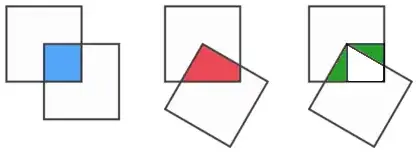

A vertex of one square is pegged to the centre of an identical square, and the overlapping area is blue. One of the squares is then rotated about the vertex and the resulting overlap is red.
Which area is greater?
a diagram showing overlapped squares, one forming a smaller blue square and the other an irregular red quadrilateral
Let the area of each large square be exactly $1$ unit squared. Then, the area of the blue square is exactly $1/4$ units squared. The same would apply to the red area if you were to rotate the square $k\cdot 45$ degrees for a natural number $k$.
Thus, I am assuming that no area is greater, and that it is a trick question $-$ although the red area might appear to be greater than the blue area, they are still the same: $1/4$.
But how can it be proven?

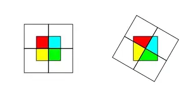

316
some text
The four numbered areas are congruent.
[Added later] The figure below is from a suggested edit by @TomZych, and it shows the congruent parts more clearly. Given all the upvotes to the (probably tongue-in-cheek) comment “This answer also deserves the tick for artistic reasons,” I’m leaving my original “artistic” figure but also adding Tom’s improved version to my answer.

    This answer also deserves the tick for artistic reasons. – BenM May 11 '18 at 06:09
    A great example of "proof by picture" that actually works. –  May 11 '18 at 14:46
    This is not the same as the answer by Ross and Zoltan. I like this one better. Theirs was the first that came to my mind, too. – Carsten S May 11 '18 at 23:09
    Can Wolfram Alpha draw that? – Willtech May 12 '18 at 02:44
  • I don't see how this answer proves the result. It just seems to assert it. What am I missing? – Frank Shmrank May 19 '18 at 14:45
    @FrankShmrank The original poster asked within the question how it can be proven that the red area equals 1/4 (which would settle the title question). My answer makes it clear (without a formal proof, but in proof-by-picture, that’s par for the course) that the red area is one of four congruent areas that partition the unit square, so its area is 1/4. I agree my answer is less than a complete proof of the original question, but I think (and I guess many upvoters think) that it’s convincing. There are other excellent answers that are more traditionally proof-like, so upvote your favorite(s). – Steve Kass May 19 '18 at 17:14
  • @FrankShmrank even if it does not formally prove the claim, it serves a great hint! – Mr Pie May 20 '18 at 08:20
  • I don't see how it's clear that the partitions stay congruent as the second square is rotated. – Frank Shmrank May 20 '18 at 12:20
  • I didn’t quite say that. I said they are congruent in my figure (for a given rotation.) Now, rotate the picture I drew by 90 degrees around the center. It’s the same with different numbers! Squares and “X” shapes with right angles are unchanged when rotated by 90 degrees about their center, regardless of whether they were aligned with the axes first, and the picture is just a square and an X shape with the same center. So rotating by 90° can move the numbered regions to each other, thus they are congruent. The point of a proof by picture is to not have to say this, but one should be able too! – Steve Kass May 20 '18 at 19:51

156
I think sketching the two identical triangles marked with green below makes this rather intuitive. This could also be turned into a formal proof quite easily.
Identical triangles
Zoltan
  • 2,010
    This method is similar to @RossMillikan 's answer above, but not quite the same :) I have to wait $9$ hours before I can upvote as I have reached my daily limit... but when I can, $$(+1)$$ – Mr Pie May 11 '18 at 15:00
    It's not only similar, now that I read that solution, it's actually the exact same idea. Unfortunatly that answer didn't contain any images and I just looked at the images before posting my own answer. :) – Zoltan May 11 '18 at 15:05

29
Note that for equal angles $\angle A'OB' = \angle AOB = 90^\circ$, when we subtract a common part $\angle A'OB$ from both sides, we have $\angle AOA' = \angle BOB'$, so the red and cyan triangles are congruent: $\triangle AOA' \cong \triangle BOB'$.
That implies their areas are equal, and when we add a common part $\triangle A'OB$ we get area of the $AOB$ triangle equal to the area of the $A'OB'B$ quadrilateral. Finally, the area of the two squares' common part is constant, independent on the square's rotation angle.

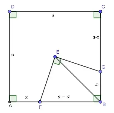

22
$\hspace{5cm}$enter image description here
$$b^2+b^2=(a-c)^2+c^2 \Rightarrow \frac{b^2}{2}=\frac{(a-c)^2+c^2}{4}\\ S=\frac{b^2}{2}+\frac{(a-c)c}{2}=\frac{(a-c)^2+c^2+2(a-c)c}{4}=\frac{a^2}{4}.$$

    The number of ways one can work this out is amazing!! Also, your answer is pure math(s)! However, I have to wait $1$ hour before I can upvote as I have reached my daily voting limit. $$(+1)$$ – Mr Pie May 16 '18 at 22:47
    Could you elaborate on how you can assert that the 2 bs are actually equal to each other? – Frank Shmrank May 19 '18 at 14:52
    @FrankShmrank, such problems help intuitive thinking and imagination. If the lower square turns clockwise, its top two sides will turn to the same angle with respect to their original positions and the sides $b$-$b$ will increase equally. – farruhota May 19 '18 at 16:21
  • @FrankShmrank I had the same problem, and then I deleted my comment and put up a new one (namely, my current one above) because I found out that by looking at the accepted answer, if the four triangles are congruent, then the two $b$s are equal to each other :) – Mr Pie May 20 '18 at 08:03

14
If we use $\overline{FB}$ for the base of $\triangle FEB$, then its altitude is $\frac 12s$. If we use $\overline{BG}$ for the length of the base of $\triangle BEG$, then its altitude is $\frac 12s$.
So the area of $\square FBGE$ is $\frac 12(\frac 12s)(s-x) + \frac 12(\frac 12s)(x) = \frac 14s^2$. Which is one-fourth of the area of the square.
