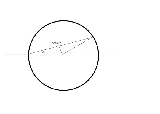

The product of the chords in this figure is
$(2\cos \frac {2\pi}{5})(2\cos \frac {\pi}{5})(2\cos 0)(2 \cos -\frac {\pi}{5})(2\cos -\frac {2\pi}{5}) = 2^5\prod_\limits {n=-2}^2 \cos \frac {n\pi}{5}$
If we map this figure to the complex plane the product of those lengths = $|(1+e^{\frac {\pi i}{5}})(1+e^{\frac {3\pi i}{5}})(1+e^{\frac {5\pi i}{5}})(1+e^{\frac {7\pi i}{5}})(1+e^{\frac {7\pi i}{5}})|$
Note: $(z+e^{\frac {\pi i}{5}})(z+e^{\frac {3\pi i}{5}})(z+e^{\frac {5\pi i}{5}})(z+e^{\frac {7\pi i}{5}})(z+e^{\frac {7\pi i}{5}}) = z^5 + 1$
Evaluated at $z= 1$
$2^5\prod_\limits {n=-2}^2 \cos \frac {n\pi}{5} = 2\\ \prod_\limits {n=-2}^2 \cos \frac {n\pi}{5} = 2^{-4}$
And this generalizes:
$\prod_\limits {n=1}^k \cos \frac {(2n-1)\pi}{2k} = 2^{-(k-1)}$
Doug M
  • 57,877
  • +1 Thanks for the answer! I don't understand how you map those up in the complex plane? (I mean how do you know for instance that the second chord is $1+ e^{3\pi i /5}$?) (Sry new to this type) – SmarthBansal May 08 '18 at 18:51
  • The "roots of unity." https://en.wikipedia.org/wiki/Root_of_unity It falls out of DeMoivre's theorem. if $z = \rho (\cos \theta + i\sin \theta) =\rho e^{i\theta}$ then $z^n = \rho^n (\cos n\theta + i\sin n\theta) =\rho^n e^{i n\theta}$ working backwards if $z^n = -1$ we can back into the possible values of $\theta$ – Doug M May 08 '18 at 19:15
