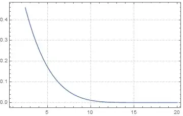

Here's a graph of probabilities that the first $5$ are correct for different values of $x$
