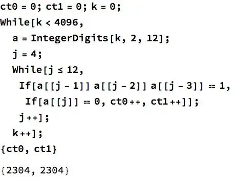

If you are not convinced: The following little program looks at all binary strings of length $12$ and counts how often $111$ is followed by a $0$, resp., by a $1$. The resulting numbers are equal.
  • Yes I agree, I did found the same results indeed – Marco Bellocchi Apr 12 '18 at 11:16
