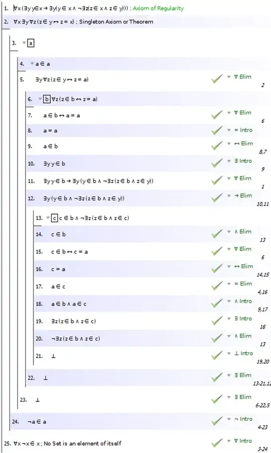

Here is a formal proof in Fitch:
Bram28
  • 100,612
