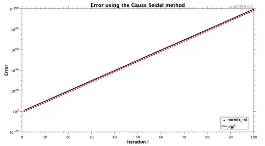

This shows, that both methods diverge as expected. As we see from $ e^{k+1} = G e^k = G^k e^0$, we have exponential growth in our error. For comparison, I added $y(\text{iteration number})=\rho(G)^\text{iteration number}$ in black. We can see that this matches the calculated errors.
Gauss Seidel method Jacobi method

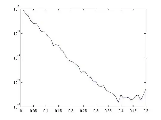

Even though this was no longer asked, I would like to say something about successive over-relaxation (SOR). This method is a modification of the Gauss-Seidel method from above. But here we introduce a relaxation factor $\omega>1$. And rewrite our method as follows: $$ (D+\omega ) x^{k+1} = -(\omega U + (\omega-1)D)x^k+\omega b$$ Normally one wants to increase the convergence speed by choosing a value for $\omega$. It basically means, that you stretch the step you take in each iteration, assuming your going in the right direction. But in our case we can make use of something similar, called under-relaxation. Here we take small steps by choosing $\omega<1$. I have done some calculations, playing with different values for $\omega$. The plot below shows the error of $x^{100}-x$ for different values of $\omega$ on the x-axis, once for $0.01<\omega<2$ and in the second plot for $0.01<\omega<0.5$. We can see, that for a value of $\omega\approx 0.38$ we get optimal convergence. Even though this might be a little more than you asked for, I still hope it might interest you to see, that small modifications in your algorithm can yield different results.
error over different omega error over different omega
