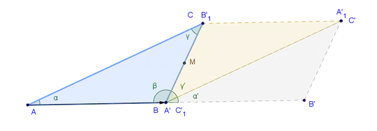

This demonstration adopts the point of view that Euclidean geometry is the study of the affine group in the plane (generated by reflections in $\mathbb{R}^2$). This group includes all translations and rotations. They preserve distances and angles. The role of this group, and in particular how parallel translation of vectors interacts with rotation, is prominent in the argument.
Translating triangle $ABC$ by vector $AB$ produces triangle $A'B'C'$ (which establishes that angle $ABB'$ is straight) and rotating $ABC$ around the midpoint $M$ of $BC$ produces triangle $A_1'B_1'C_1'$. Notice that $C=B_1'$ because $M$ is the midpoint of $BC$ and, also by construction, $C_1' = A' = B$.
Figure
Everything hinges on $A_1'$ coinciding with $C'$, as suggested in this figure. Although this is visually "obvious," there is something to be shown, because $A_1'$ is the result of rotating $ABC$ while $C'$ is the result of translating $ABC$. Among the many ways to make this demonstration, then, here is one that is geometric in spirit.
The image of vector $AB$ under the ($180^\circ$) rotation about $M$ is the vector $A_1'B_1'$. Because $180^\circ$ rotations negate vectors, $A_1'$ must be the translate of $B_1'$ by $AB$. Since (by construction) $C'$ is the translate of $C = B_1'$, $C'$ and $A_1'$ are coincident.
This shows that the straight angle $ABB'$ is decomposed into non-overlapping angles $\beta$, $\gamma'$, and $\alpha'$. Because translations and rotations preserve angles, the measure of angle $\alpha$ equals the measure of $\alpha'$ (its image under the translation) and the measure of angle $\gamma$ equals the measure of $\gamma'$ (its image under the rotation), whence the sum of the measures of $\alpha$, $\beta$, and $\gamma$ is the measure of a straight angle, $180^\circ$.
whuber
  • 8,531
    I see that rschwieb recently sketched the same approach. The figure may help in understanding it and the appeal to properties of the affine group should help make it rigorous, especially insofar as a crucial gap--proving the coincidence of $A_1'$ and $C'$--is concerned. – whuber Jan 03 '13 at 23:05
  • What have you used to sketch this figure? – B Faley Jan 04 '13 at 08:26
    @Meysam Geogebra is a free Java application designed for geometric illustrations. It's mature and works well. – whuber Jan 04 '13 at 13:53
    @whuber Thanks for recognizing our solutions have the same idea. I'm glad you offered more details: it's not my field, and I was just providing the easiest explanation I could think of. – rschwieb Jan 04 '13 at 15:11
