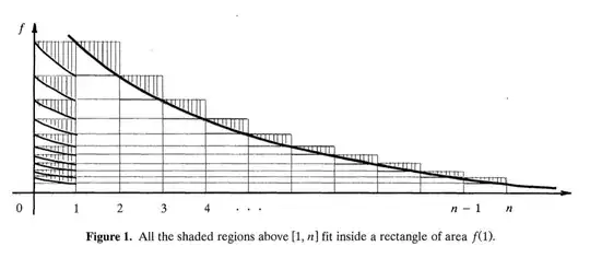

In Tom Apostol's expository article (here's a free link), upon seeing the figure below (or this from the Wolfram project) I was expecting more diagrams to come to continue the error decomposition of the shaded regions in the shape of "curved triangular pieces".
For each horizontal unit interval, it seems that the hypotenuse of an implicit triangle (within shaded region) is the linear correction. Then, there's a "cap" that fills in the gap between the hypotenuse and the actual curve. In this figure, each cap is attached to the implicit hypotenuse from below due to the curve being convex.
It was a disappointment not seeing further decomposition of the "cap" into regions described by parabolic, cubic, then quartic curves etc. Somehow none of the textbooks and other materials I've read have such diagrams for higher orders.

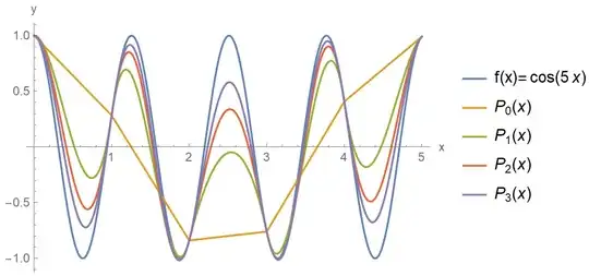

This is a picture of visualization for $f(x)=\cos(5x)$. You can see that as $n$ increases, $P_n(x)$ gets close to $f(x)$.
Graph of <span class=$P_0(x), P_1(x), P_2(x), P_3(x)$ for $f(x)=\cos(5x)$" />

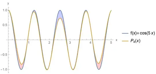

And this a picture that visualizes the error for $n=4$, positive area is red and negative area is blue.
Error for <span class=$n=4$, $f(x)=\cos(5x)$" />
As I mentioned earlier, $P_n(x)$ can diverge if the remainder term of the Euler-Maclaurin formula diverges. You can check this by an example, $f(x)=\cos(7x)$. The graph is in below.
Graph of <span class=$P_0(x), P_1(x), P_2(x), P_3(x)$ for $f(x)=\cos(7x)$" />

f[x_] := Cos[5 x];
a = 0; b = 5;
getsolp[n0_, k0_, x_] := Module[{n = n0, k = k0}, g[zeta_] := Sum[c[i] * zeta^i, {i, 1, 2 n + 1}] + c[0]; cond = Join[{g[k] == f[k]}, {g[k + 1] == f[k + 1]}, Table[(D[g[zeta], {zeta, 2 j - 1}] /. zeta -> k) == (D[f[zeta], {zeta, 2 j - 1}] /. zeta -> k), {j, 1, n}], Table[(D[g[zeta], {zeta, 2 j - 1}] /. zeta -> k + 1) == (D[f[zeta], {zeta, 2 j - 1}] /. zeta -> k + 1), {j, 1, n}]]; sol = NSolve[cond, Table[c[i], {i, 0, 2 n + 1}]]; g[x] /. sol ]
P[n_, x_] := getsolp[n, Floor[x], x]
Plot[{f[x], P[0, x], P[1, x], P[2, x], P[3, x]}, {x, a, b}, PlotLegends -> {"f(x)", Subscript[P, 0][x], Subscript[P, 1][x], Subscript[P, 2][x], Subscript[P, 3][x]}, AxesLabel -> {"x", "y"}]
Plot[{f[x], P[4, x]}, {x, a, b}, Filling -> {1 -> {{2}, {{Opacity[0.2], Red}, {Opacity[0.2], Blue}}}}, PlotLegends -> {"f(x)", Subscript[P, 4][x]}, AxesLabel -> {"x", "y"}]
