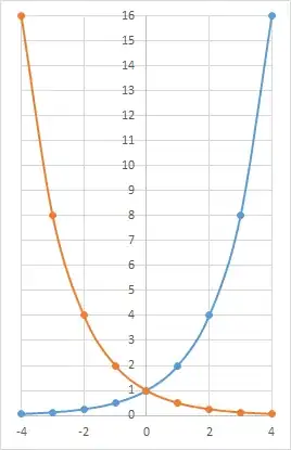

2IMO I feel like this is kind of 'cyclic'. The reason they meet at $(0, 1)$ is because $x^0=1 ,\forall,x\in \Bbb R \setminus {0}$... it doesn't quite explain why that's the fact in the first place. – Andrew Li Mar 14 '18 at 01:10
@AndrewLi: the figure draws you to think about the relation between $a^x$ and $a^{-x}$ and induces the equation $y=y^{-1}$. – Mar 14 '18 at 07:40
