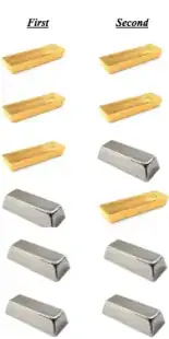

There are three boxes, each with a different combination of gold and silver bars in them: One has two gold bars, one has a gold and a silver bar, and one has two silver bars. If a bar from a box is chosen at random, if that bar is a gold bar, what is the chance that the other bar in the box is gold?
Although the solution may seem to be $\frac{1}{2}$, it is actually $\frac{2}{3}$. There are three gold bars that could've been chosen:
Cases of Box Problem
There are two gold bars that could've been in the same box, and one silver bar, therefore the probability is $\frac{2}{3}$. (This problem is very similar to the Monty Hall problem.)
