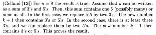

(Exercise 19 from this book) Show that each integer $n>7$ can be written as a sum containing only the numbers $3$'s and $5$'s. For example: $8=3+5$, $9=3+3+3$, $10=5+5$.
My proof (strong induction): Base cases are already shown in the statement. Suppose that the statement is true for all numbers $11\leq n\leq k$. Now, let us observe number $n=k+1$. We have $$k+1=(k-2)+3,$$ and $k-2$ can be written with only $3$'s and $5$'s by the inductive assumption (and the base case) since $k-2\geq 9$. So we have proven our statement.
Solution from the book (weak induction):
My concern is if my use of strong induction is wrong in this case in some way, or just not "pretty enough" for this problem?
Is there any reason why it is not good idea to tell students of introductory class in number theory that they can use strong induction whenever they feel they need it? Is it wrong to write assumption as in the strong case every time, even if you use only $k$ to prove $k+1$?

  • It's fine either way. Your version is simpler (quicker and easier to see at a glance), but in defense of the book, since strong induction can be easily avoided, the author chose to stay with the more elementary version (i.e., ordinary induction). – quasi Mar 01 '18 at 09:10
  • @quasi I also like the proof from the book better :) Even though the strong induction always cross my mind first! But in this case proof with strong induction is almost trivial – Meow Mar 01 '18 at 09:12
  • @quasi Since strong induction always works, whereas ordinary induction only works for the natural numbers, one might also ask: Why ever bother with ordinary induction? – Tobias Kildetoft Mar 01 '18 at 09:13
    @Tobias Kildetoft: Well, ordinary induction is conceptually simpler, so for a problem where strong induction isn't needed, and offers no saving of steps, why use it? – quasi Mar 01 '18 at 09:17
